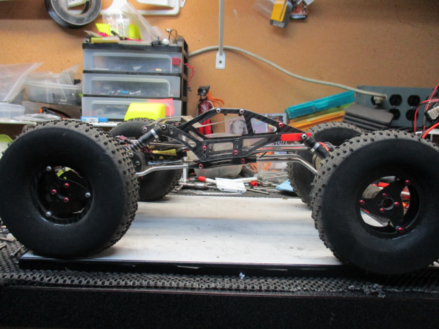

    So onto the present ..... Whats inside ....
    XR10 Axles front and rear. I was running our KR4 rear axle for a couple seasons with much success but it wasnt letting me try a new setup. Switching back to the XR10 rear let me lower my roll centers all the way around.
    Also on the front I was running the upper links high using 3mm spacers under the axle mount. I took those out and went back to stock height. This with the rear change let me lower the RC's all around and Im loving it. Very agressive and very predictable.
    SCX Shocks - no they dont leak. I actually rebuilt them recently using the X-rings that Vanquish sells for their shocks. They fit perfect and with some green slime I havent seen them leak yet!
    For springs Im still using the trusty Losi MiniT silvers front and rear. I put the yellow pistons from our SCX tuner sets in both front and rear to help with balance. For oils Im running 35wt front and 60wt rear. Although I think the front is a little too stiff, it takes a bit longer to compress so Im gonna drop the oil to 30wt front and leave the rear alone.
    Motors - Team Brood! Being a long time fan of Brood and knowing Eddies history and knowledge you cant go wrong with the custom built motors he gets you. Control and Power no matter where your trigger finger is at.
    Tires for now are some simple Voodoo Silvers but Im anxiously waiting to get some new Prolines in hand to try.
    Other then that its simple electronics. Hitec 7950 Servo - they have never let me down and always been more then enough power. ESC's are Holmes Minis all wired through the Sanwa MT4 Radio, long live the thumb lever!
    And all that gets wrapped up to weight in at 3.8lbs ...... Ive never had much luck below the 4.00* mark at all but this new link setup Im playing with has really helped closed the window of tuning mistakes and makes the truck drive like a dream.

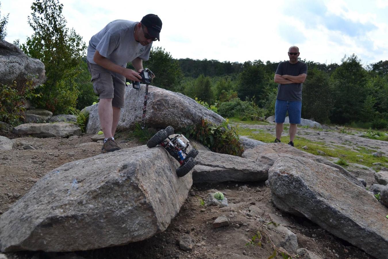

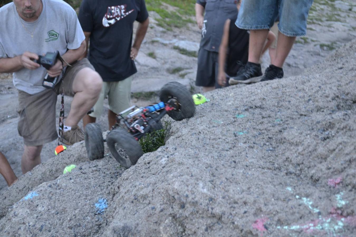

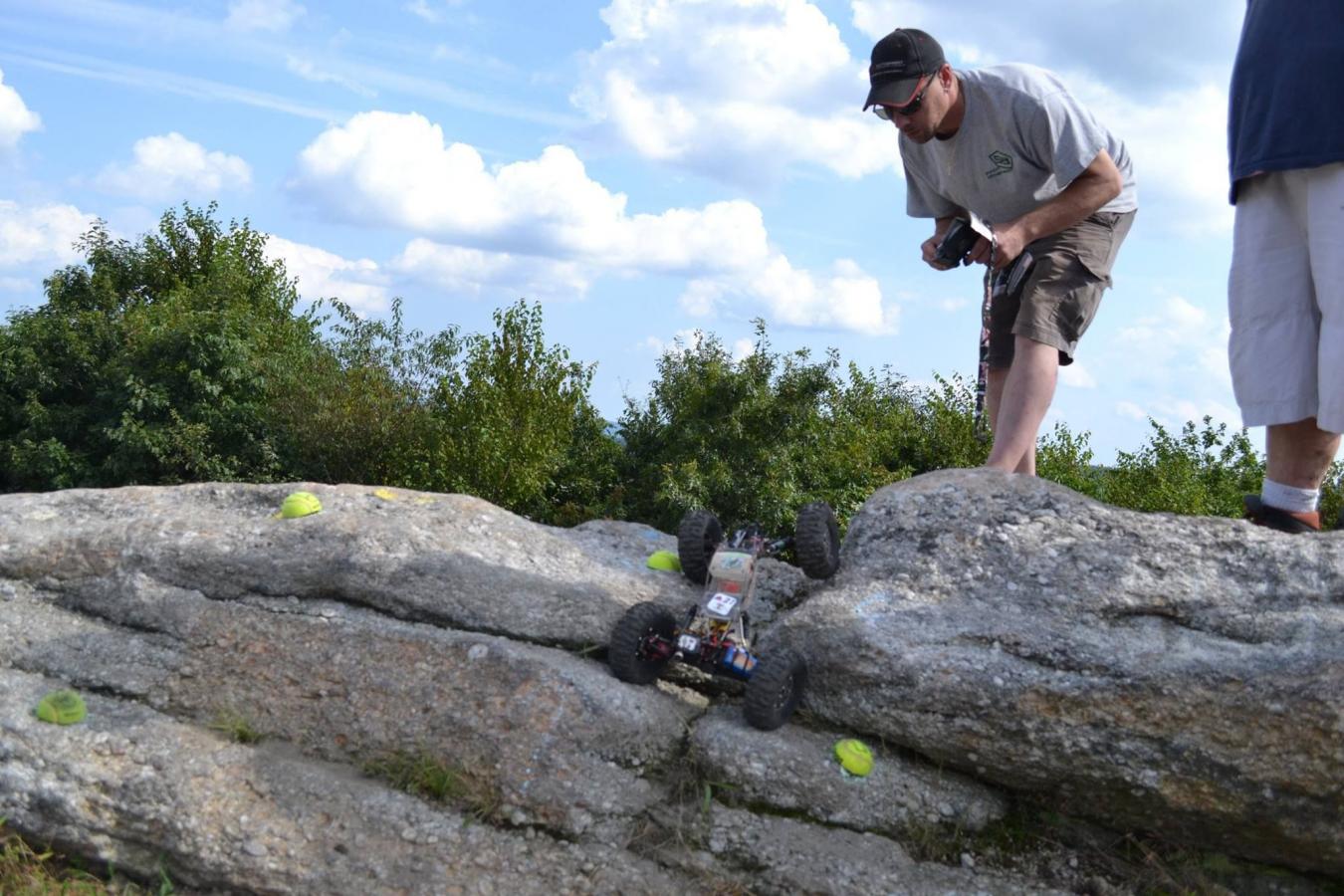

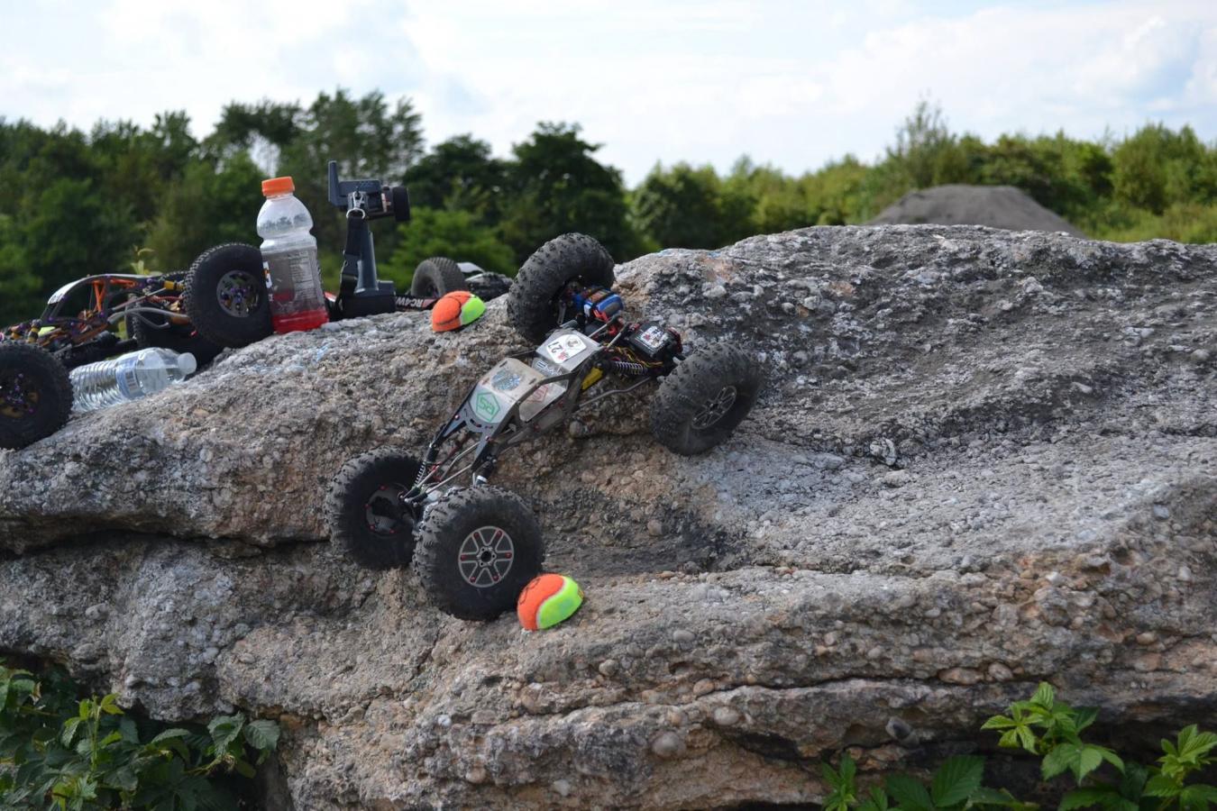

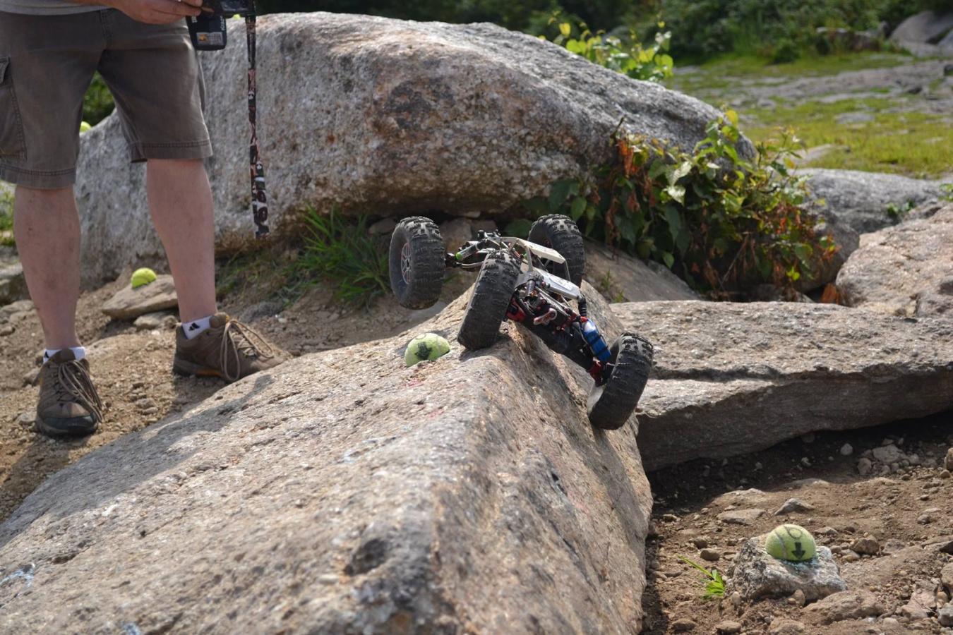

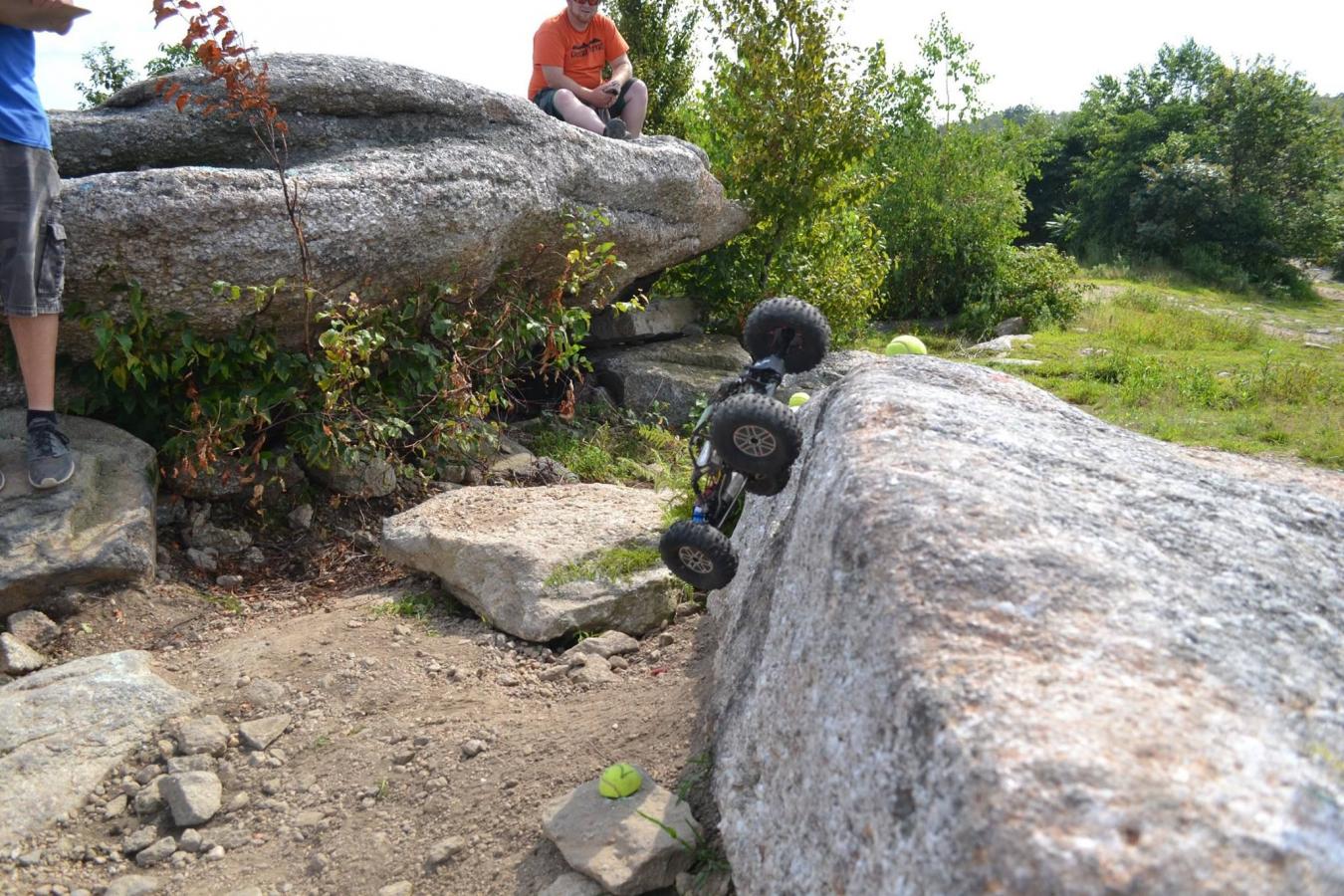

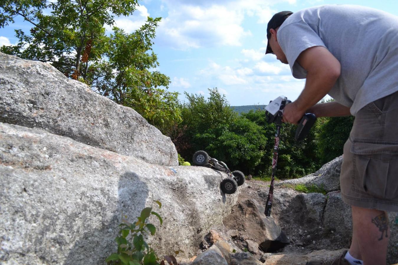

    Just a few action shots from Rausch Creek NENC a couple years - Finished 3rd on the podium that day.
    The truck was spot on with 1 course costing me some critical points at the second slot.

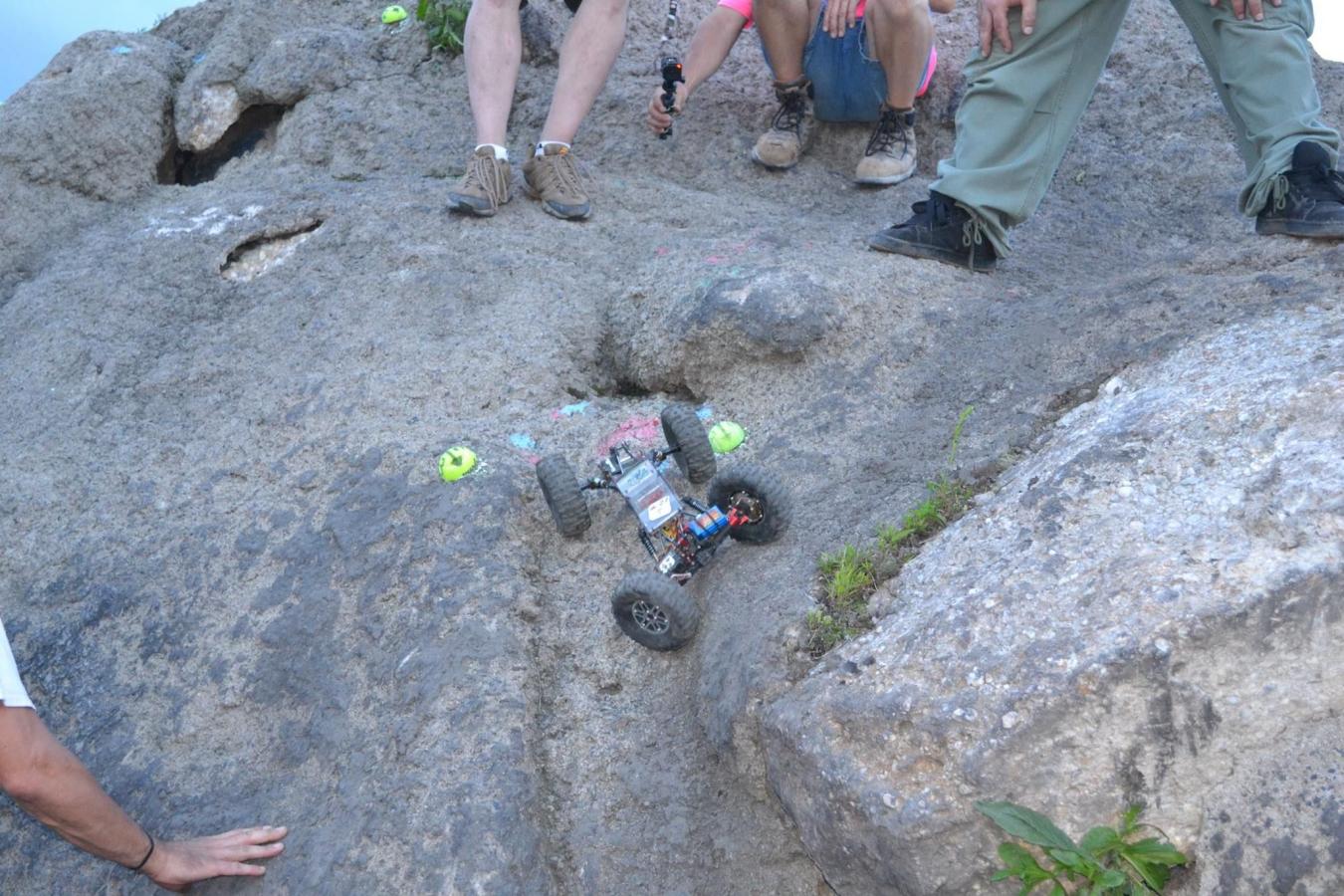

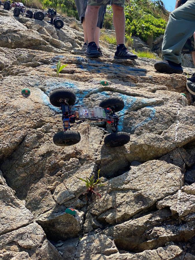

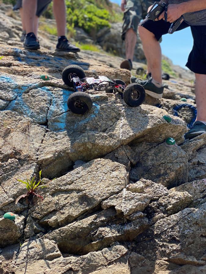

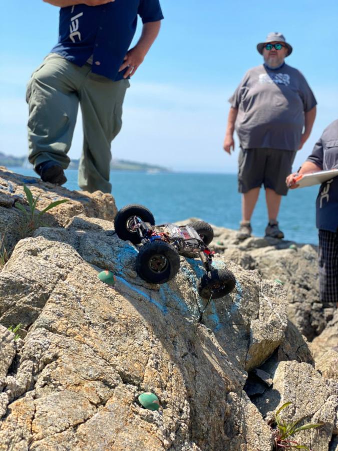

      Some action shots from this past weekend now up in Fort Wetherill - 2 years after these NENC pics and the truck is still incredible.
      Had 3 GREAT courses and 1 DNF course. Got greedy from the get go doing a Bonus I had no business doing lol. But finished 2nd for the day among top tier drivers even after that.
      Playing with some new stup stuff on the truck and definately feels like the right direction.
