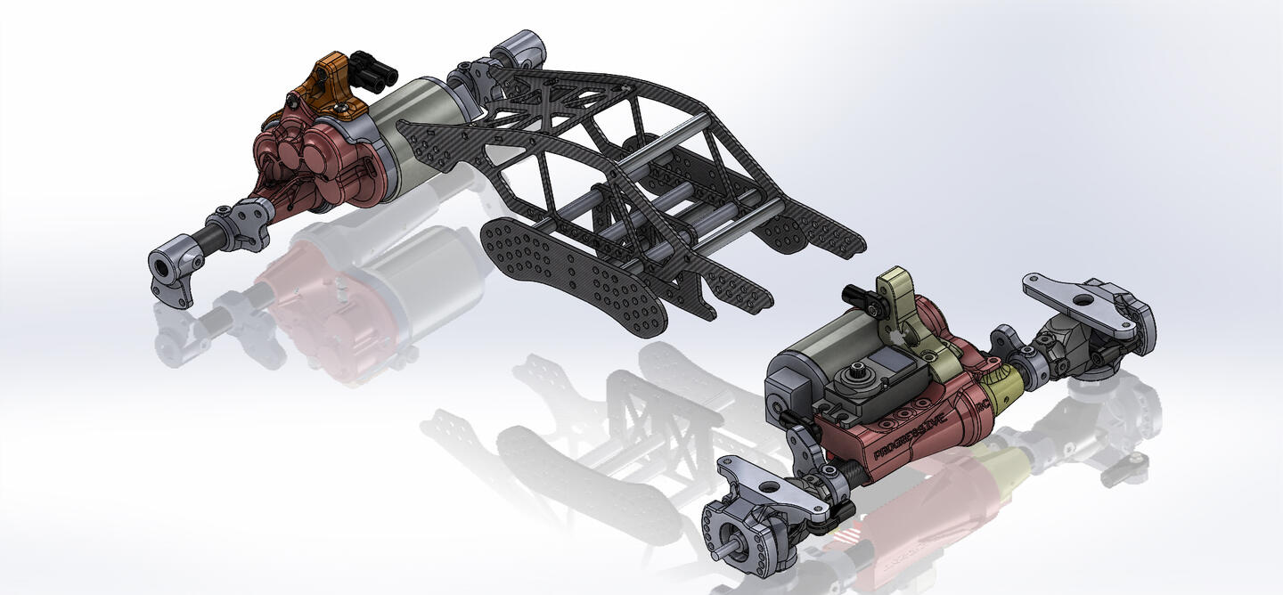

    Out came SolidWorks and the work began...

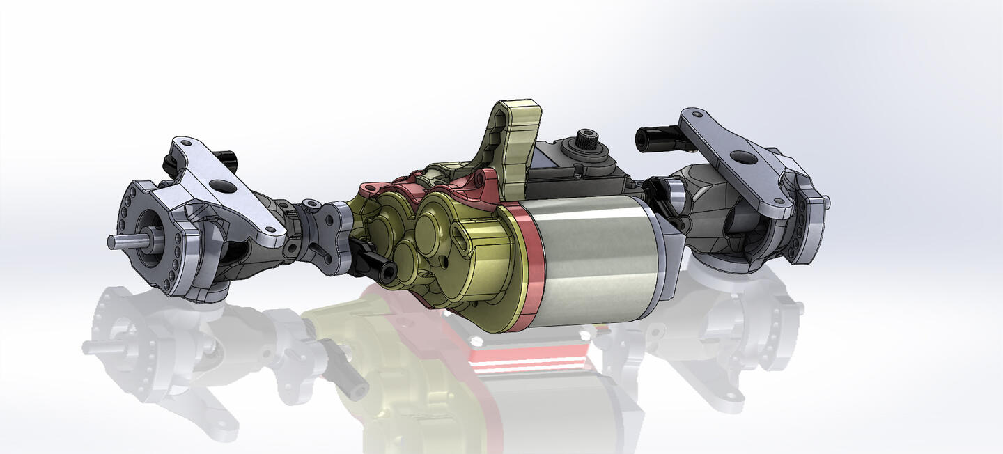

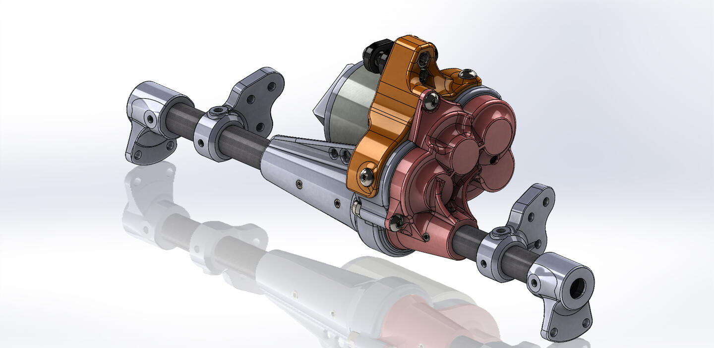

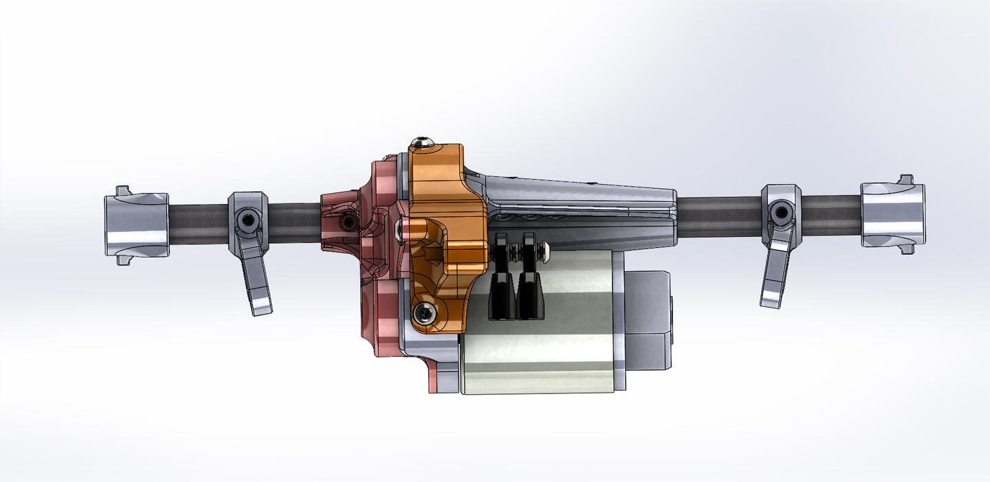

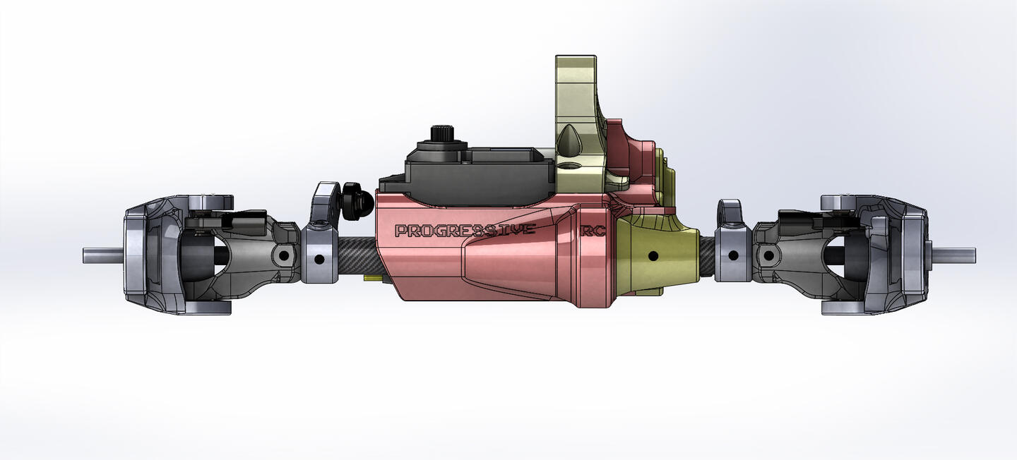

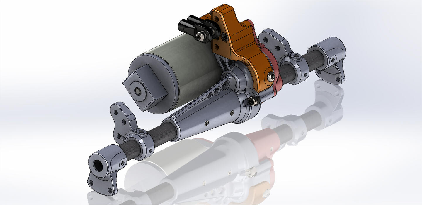

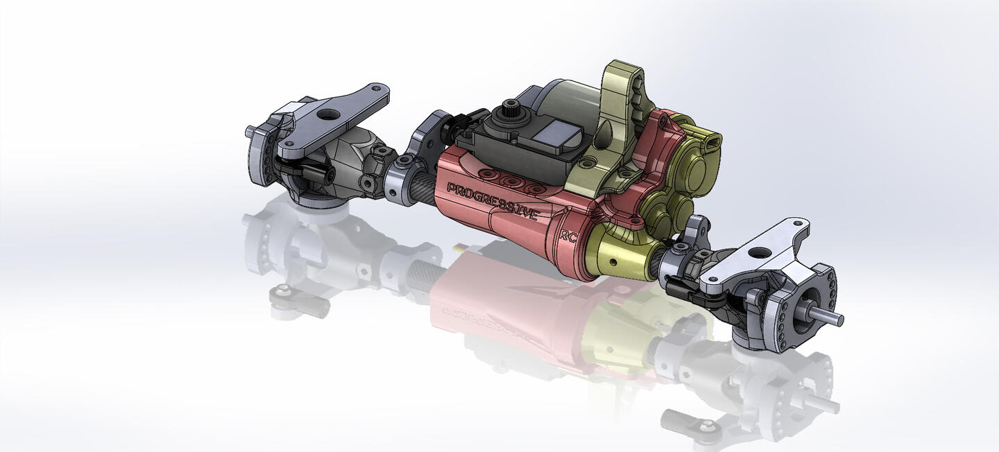

    Plan was:
    - Custom gear cases (3d printed)
    - Carbon fiber tubes
    - 3d printed Chubs to mount on the CF tube
    - While we were at it why not custom knuckles as well right?
    - Rear axle to have the motor as tight to the tube as possible
    Click image for larger version  Name:	Front axle 1.JPG Views:	0 Size:	78.4 KB ID:	769
    Click image for larger version  Name:	Front axle 2.JPG Views:	0 Size:	80.5 KB ID:	770
    Click image for larger version  Name:	Front axle 3.JPG Views:	0 Size:	61.7 KB ID:	771
    Click image for larger version  Name:	Rear axle 1.JPG Views:	0 Size:	91.7 KB ID:	772
    Click image for larger version  Name:	Rear axle 3.JPG Views:	0 Size:	64.5 KB ID:	773
    Click image for larger version  Name:	Rear axle 4.JPG Views:	0 Size:	83.9 KB ID:	774

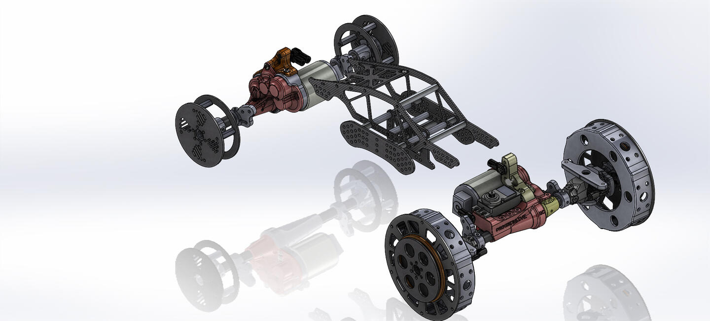

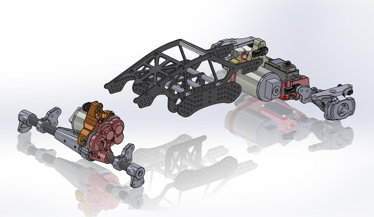

    After that I decided to update my chassis with some changes, mainly to the upper cabin.
    Click image for larger version  Name:	Chassis Completo V5_2.JPG Views:	0 Size:	124.1 KB ID:	775
    Click image for larger version  Name:	Chassis Completo V5_3.JPG Views:	0 Size:	101.0 KB ID:	776
    And finally add some wheels why we are at it (because renderings are so cool).
    Click image for larger version  Name:	Chassis Completo V5_4.JPG Views:	0 Size:	87.4 KB ID:	777

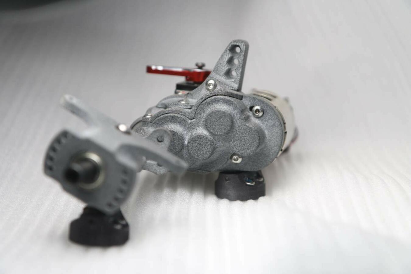

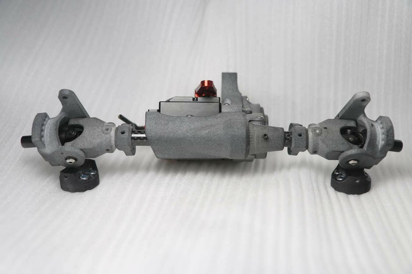

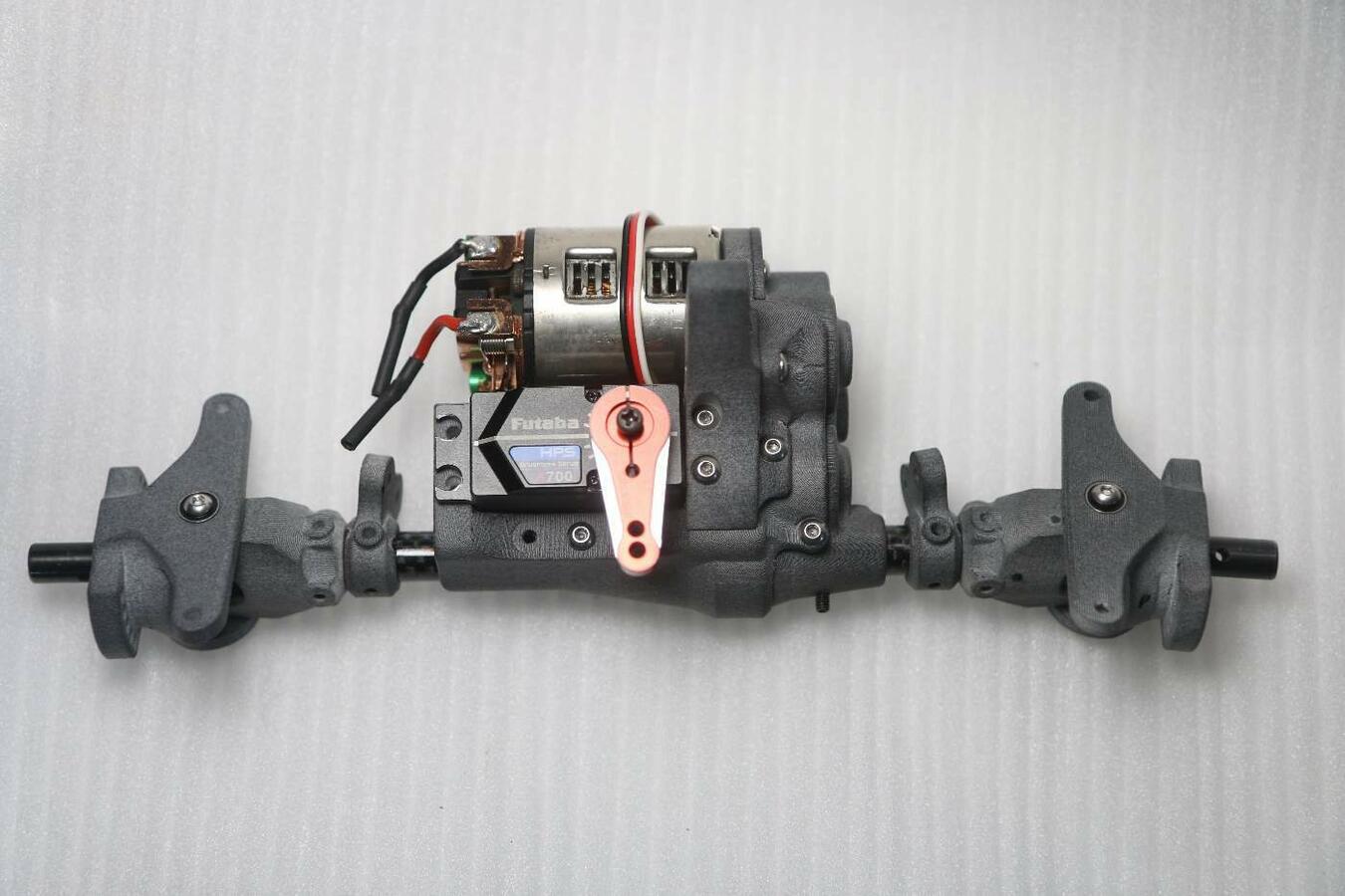

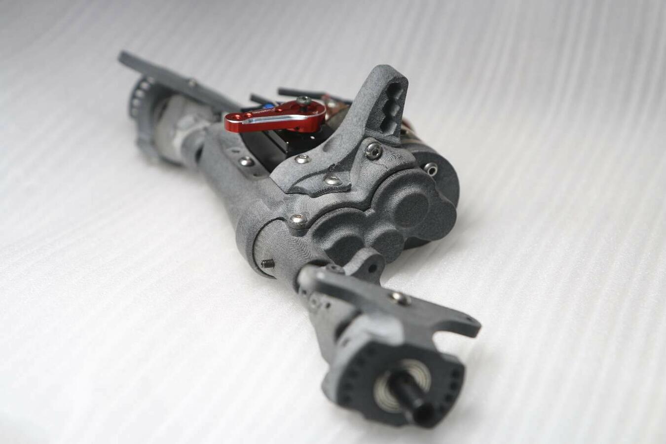

    The first version of the front axle was already made and everything had a snug fit.
Name:	Photo Resizer 2021_05_11_09_21_50.jpg
Name:	Photo Resizer 2021_05_11_09_22_35.jpg
Name:	Photo Resizer 2021_05_11_09_23_01.jpg
Name:	Photo Resizer 2021_05_11_09_23_18.jpg
    The second version is already printed, as well as the rear axle.
    Everything looks to be correct but only final assembly and field testing will tell.
    So far it as been a very cool project.
    I have plans to make a complete replacement case (all printed without CF tubes), for the bully 2 axles that will accept the Bully chubs, knuckls and shafts.
    As far as gearing a 10t pinion should fit, meaning I could have a 57:1 ratio.
    This would put me in Super territory.
    The only downfall is that the ID of the tube is only 6mm. some sort of custom shaft would have to be built...
    I will try to keep this updated as I go along.
