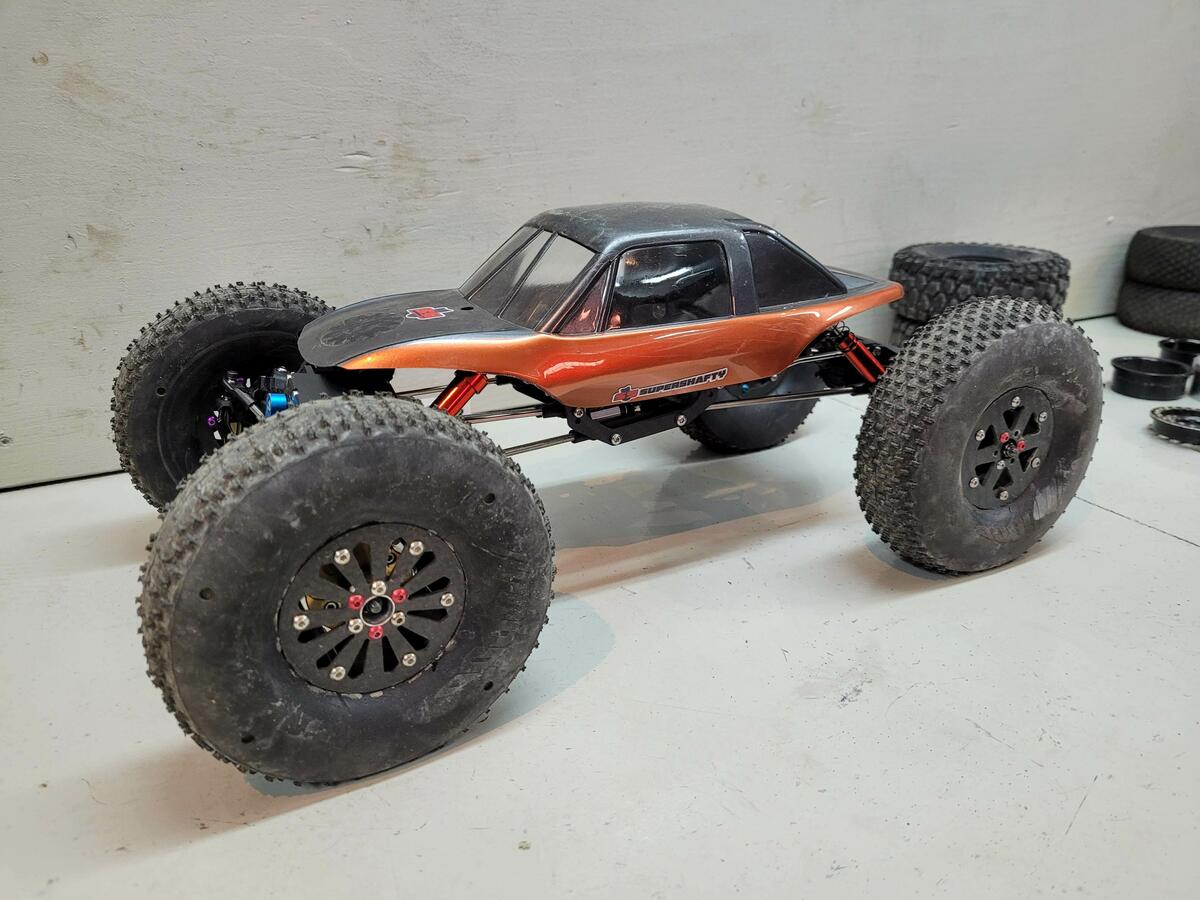

    Decided to scrap the Sparetime chassis, and build a new shafty based on the newly released Krazed Builds un-Stuck 3G chassis.
    Specs will be close to last one;
    - Parma Xciter body
    - Dlux Hamberger SAF trans
    - Holmes Magnum 11tXX
    - Holmes BR Mini
    - Sanwa RX-482
    - Holmes Hobbies SHV500V3 direct powered servo
    - Axial Capra axles
    - Team Garage Hack Wild Overdrive front portal gears
    - 2.2", 1" wide Crawler Keller carbon wheels
    - Narrowed Voodoo Pins, silver front, blue rear
    - Narrowed 5.5" CI dual stage foams, comp cut soft front, standard medium rear with tuning ring
    - Servo, battery and electronics mount for axle designed and printed by me
    - Short Dravtech shocks (15wt front, soft springs - 20wt rear, medium springs)
    - 3mm Titanium homemade upper links
    - 4mm TItanium homemade lower links
    - Traxxas T-Maxx and E-revo driveshafts

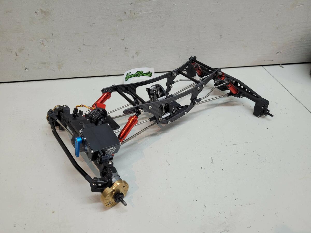

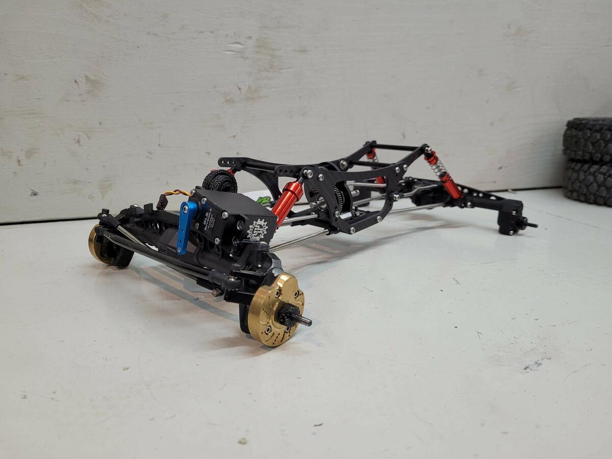

    Mock-up:

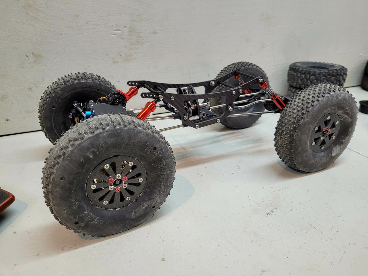

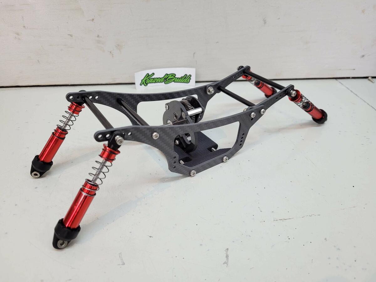

    Mock up with wheels

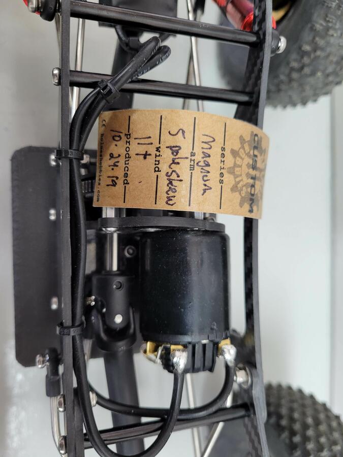

      Looking forward to testing this on the rocks! The Puller 400 found its way to my Pscale Sherpa instead, got tired of the revolver noise

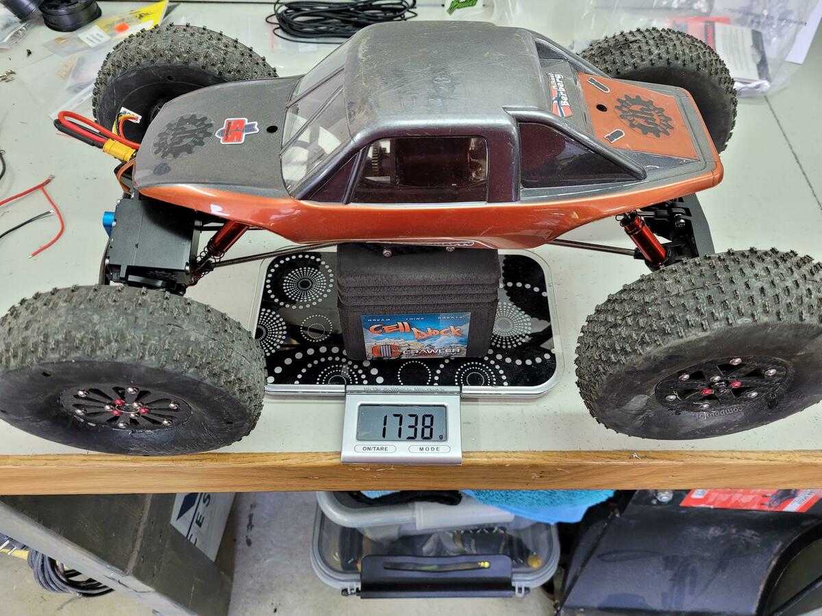

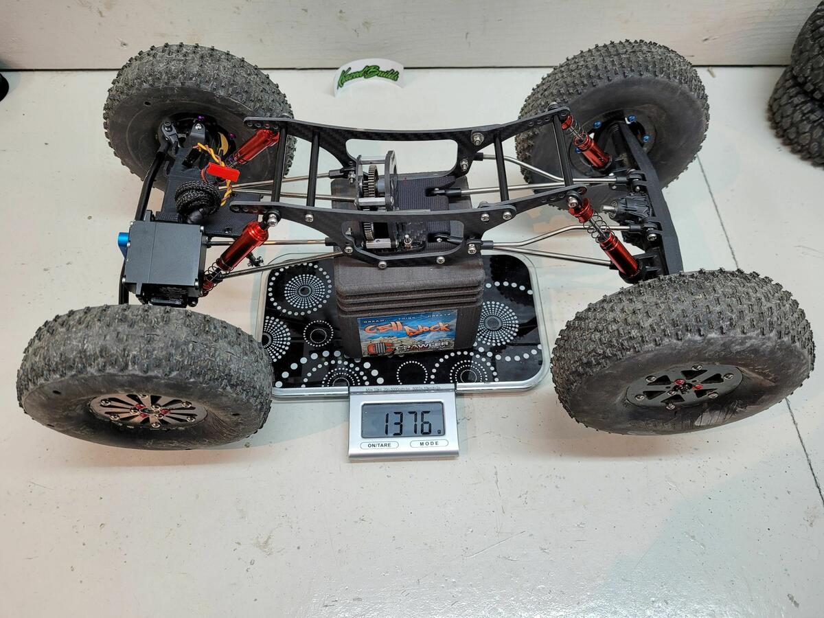

      Almost RTR weight with 450mah 3S battery (only missing bodymounts)
