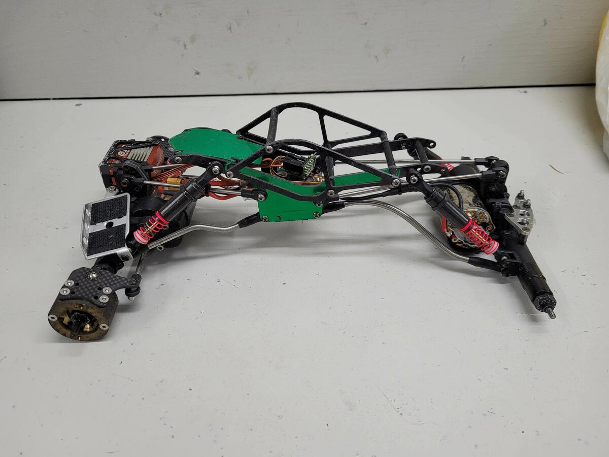

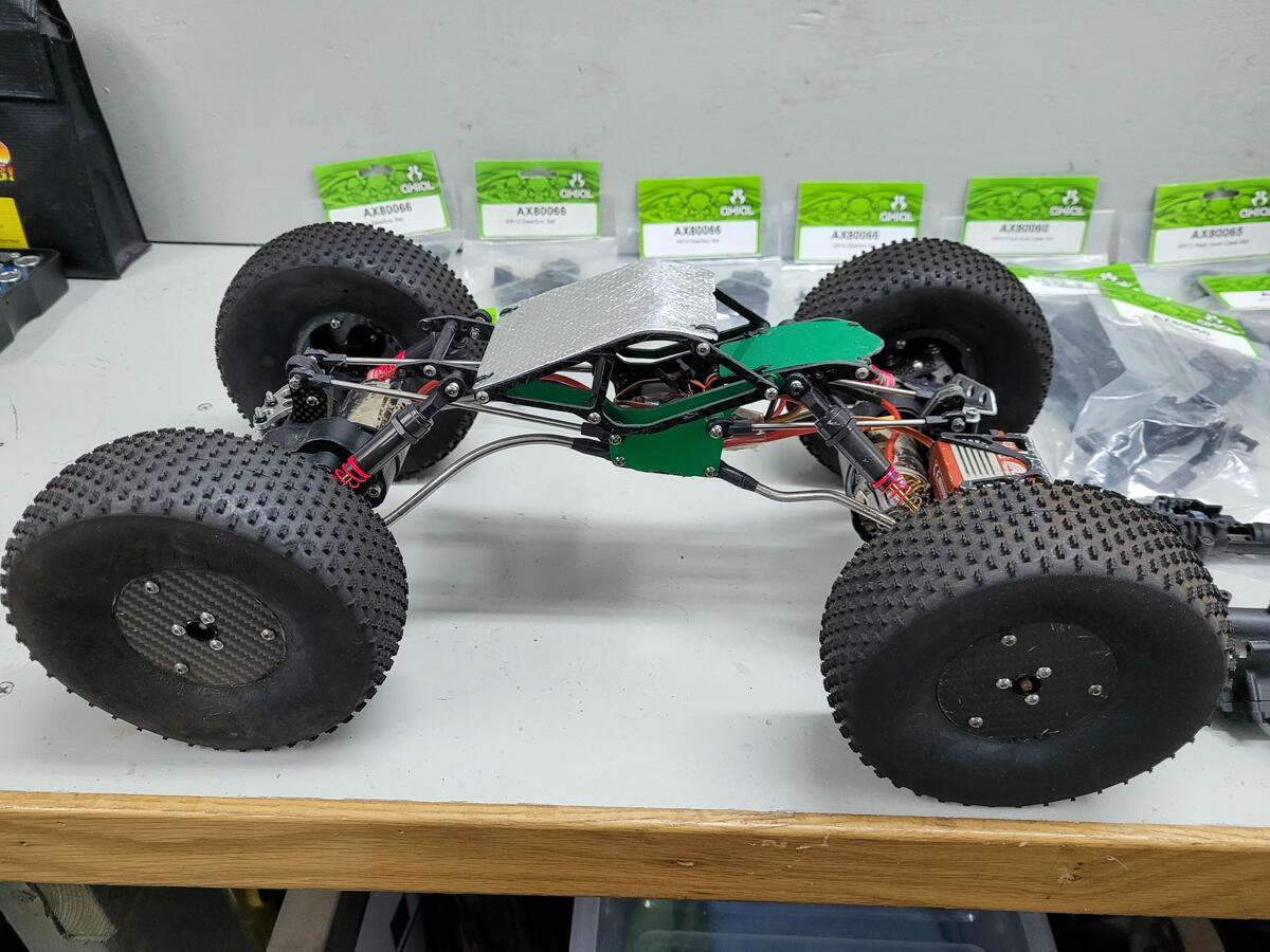

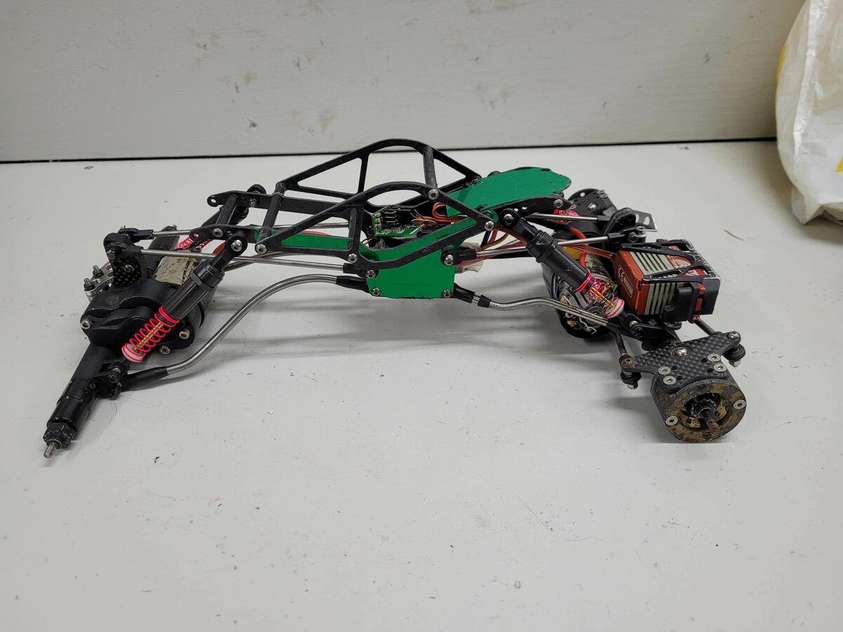

    I have always wanted a MOA, and when I recently came across a SuDu Pro XR10 I jumped on the deal to get a decent entrance in to the 2.2M class
    It has already been built and driven many years here in Norway.
    Here it is when I recieved it:

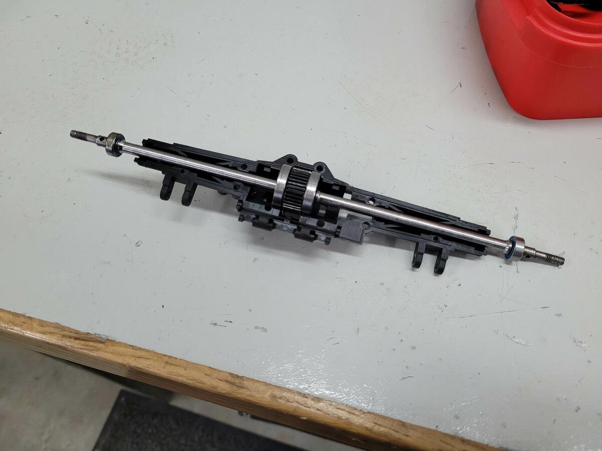

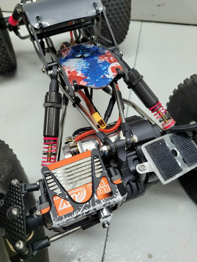

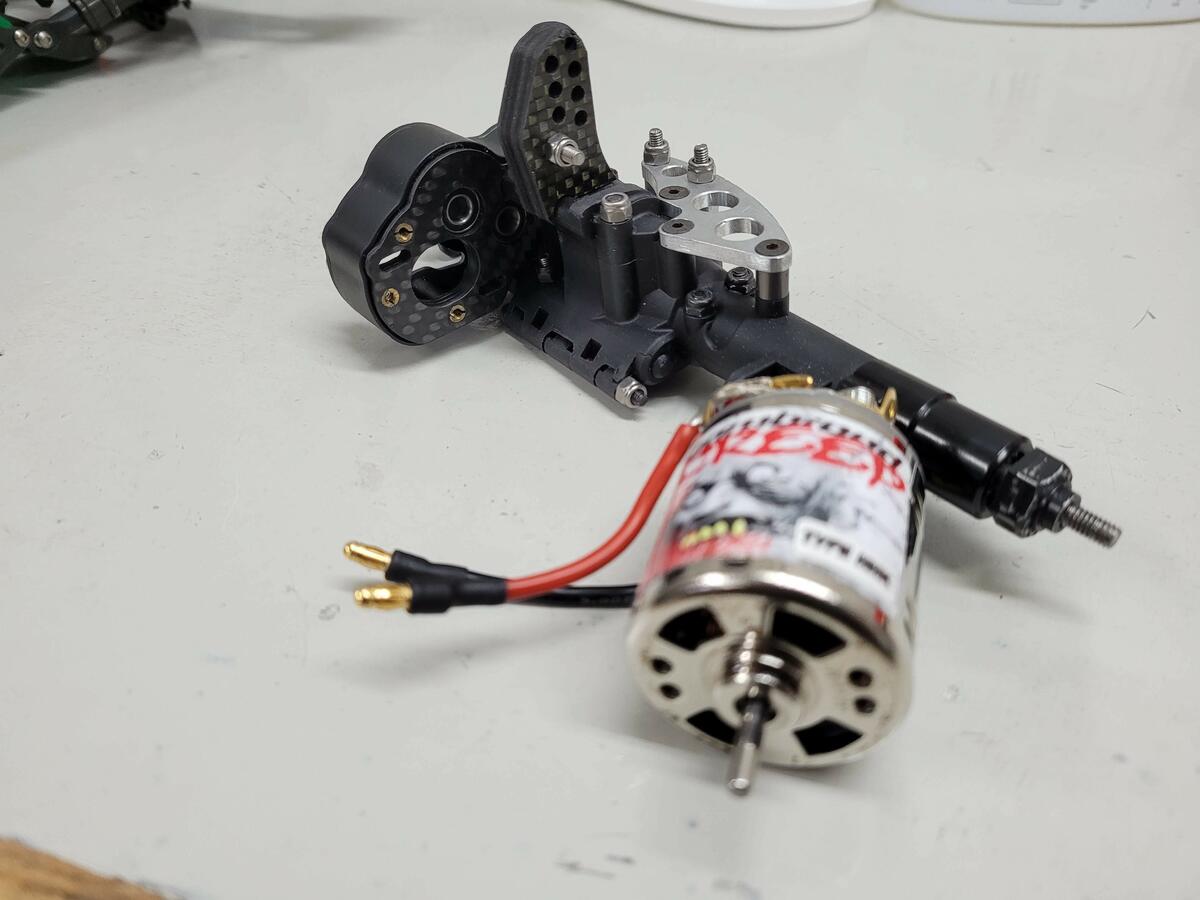

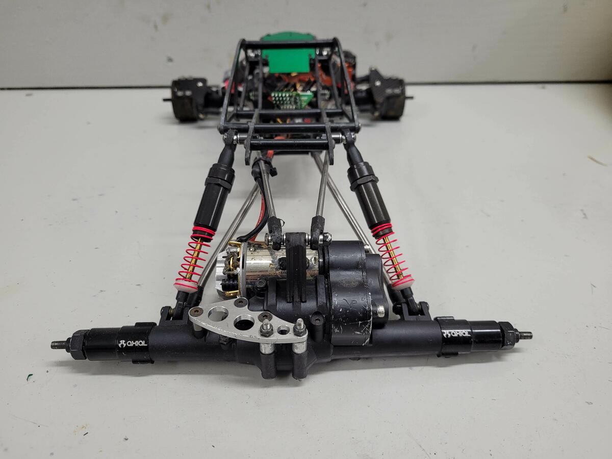

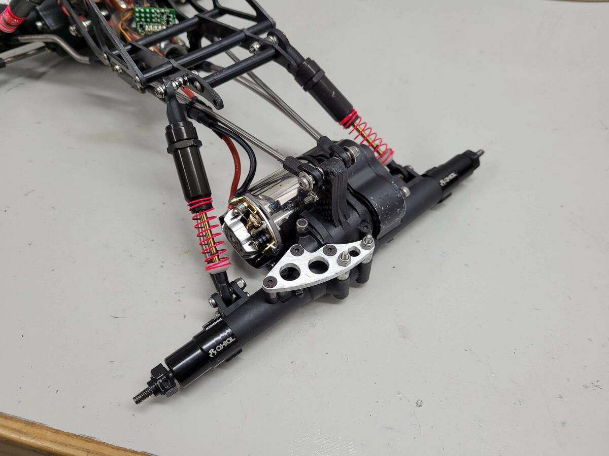

    The axles are pretty well built from my understanding, but I disassembled them to give them a health check, swap bearings and grease them again.
    Lets start with rear axle
    From my research, these are the specs:
    - 2 bolt mod
    - CreeperBob titanium axle shafts
    - All Axial Machined gears
    - Titanium upper shaft
    - Traxxas Oilite small bearing (I replaced this with new oilite)
    - VP alu transmission housing
    - Krazed Builds motorplate and upper link mount
    - BWD Blade stiffener
    - Axial alu lockouts
    - Team Brood Creep 35T motor

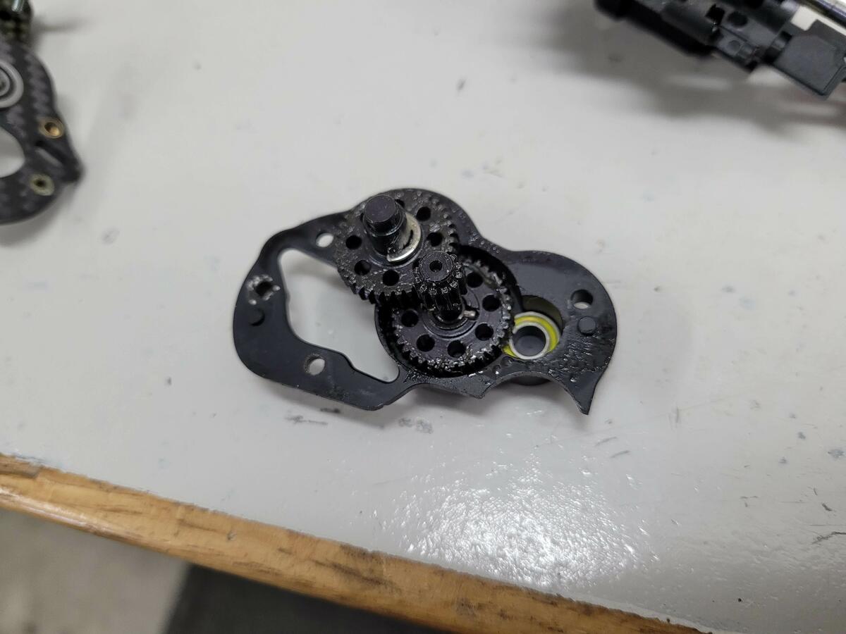

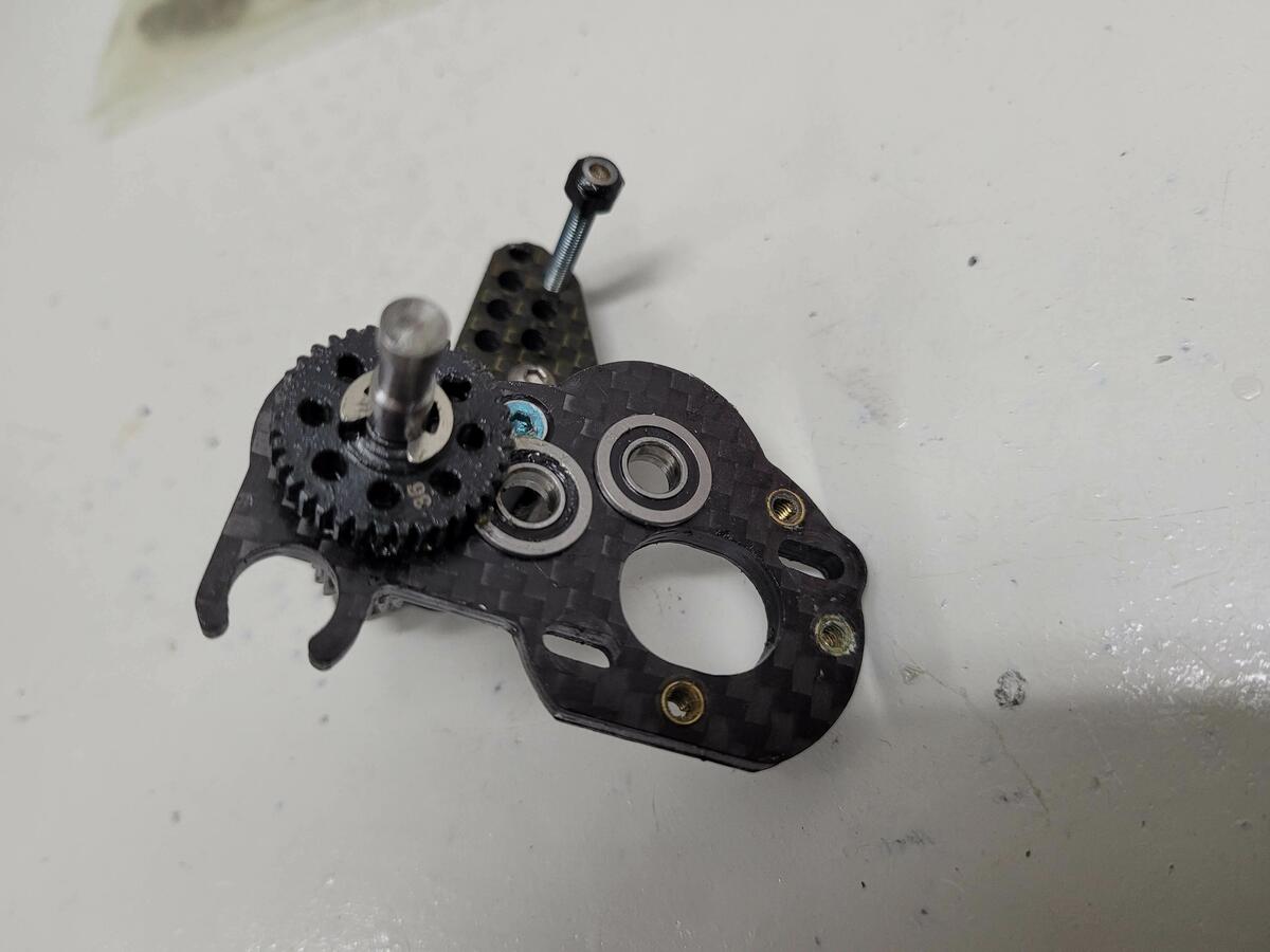

    Gears looked perfect

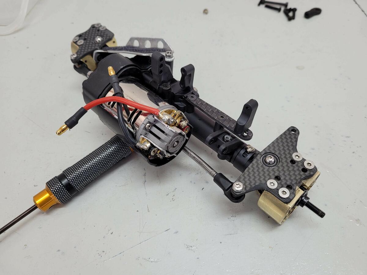

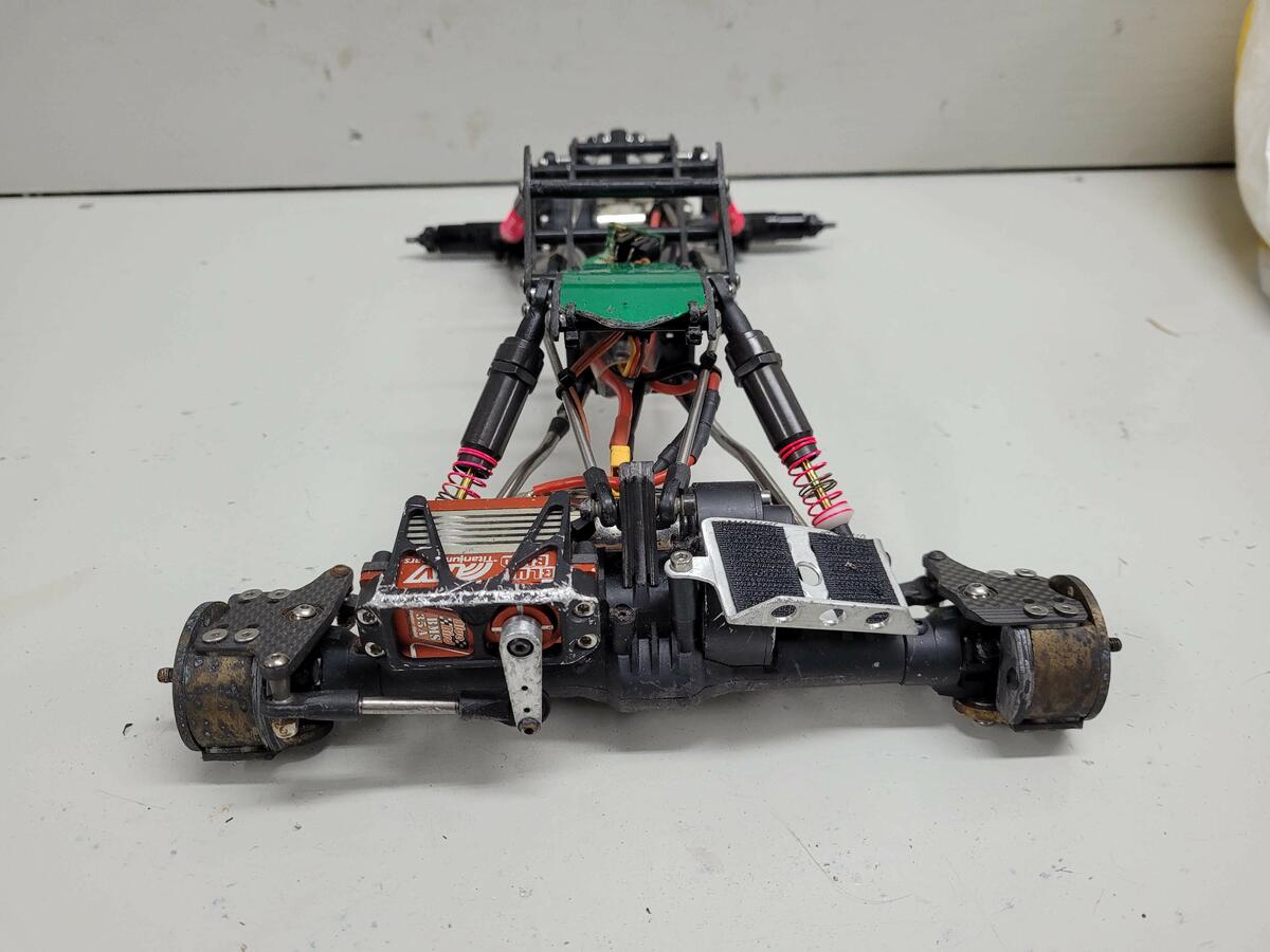

    Assembled back together, motors will need new brushes and a comm cut later on, but they are good for now:

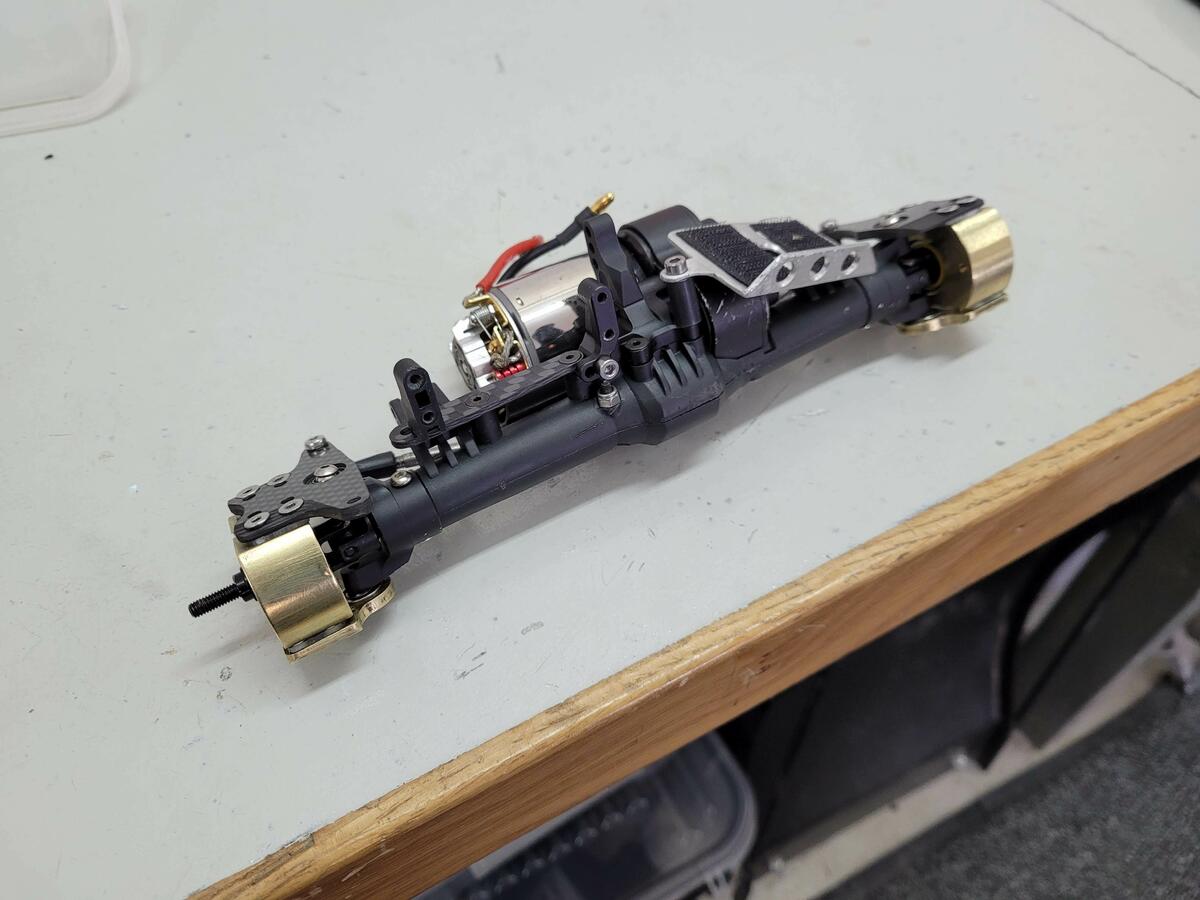

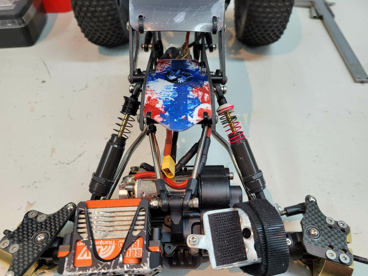

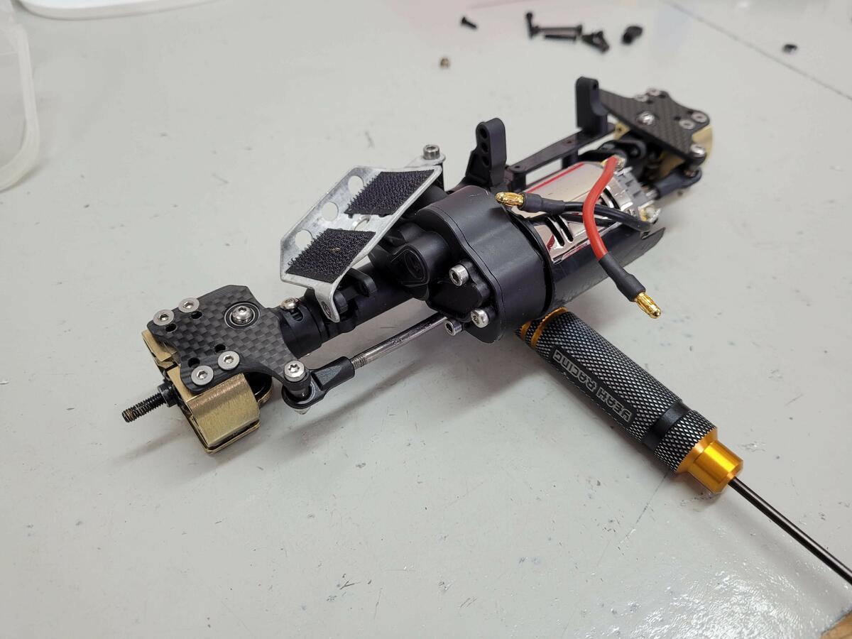

      I then proceeded to do the same thing on the front axle,
      specs:
      - VP Upper link mount and servo mount
      - VP C hubs
      - Dlux brass knuckles
      - Rowdy Racing battery mount

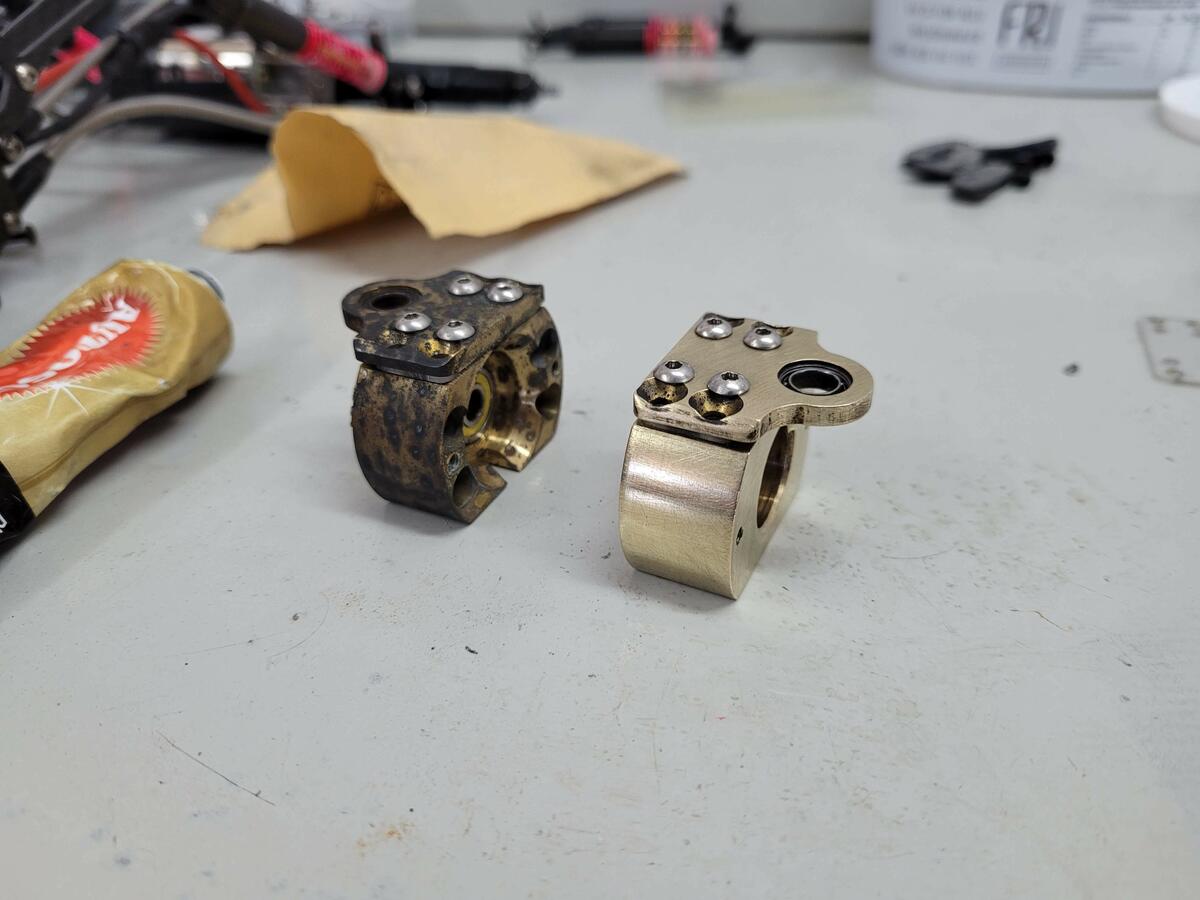

      First of I started by cleaning the really bad knuckles
      I removed the slugs inside the knuckles and addifitonal brass ring, as I felt the knuckle provided enough weight itself. I will play around with either Loaded Dice or Pat's weight hanger later on.
      After new bearings and grease, put together again:

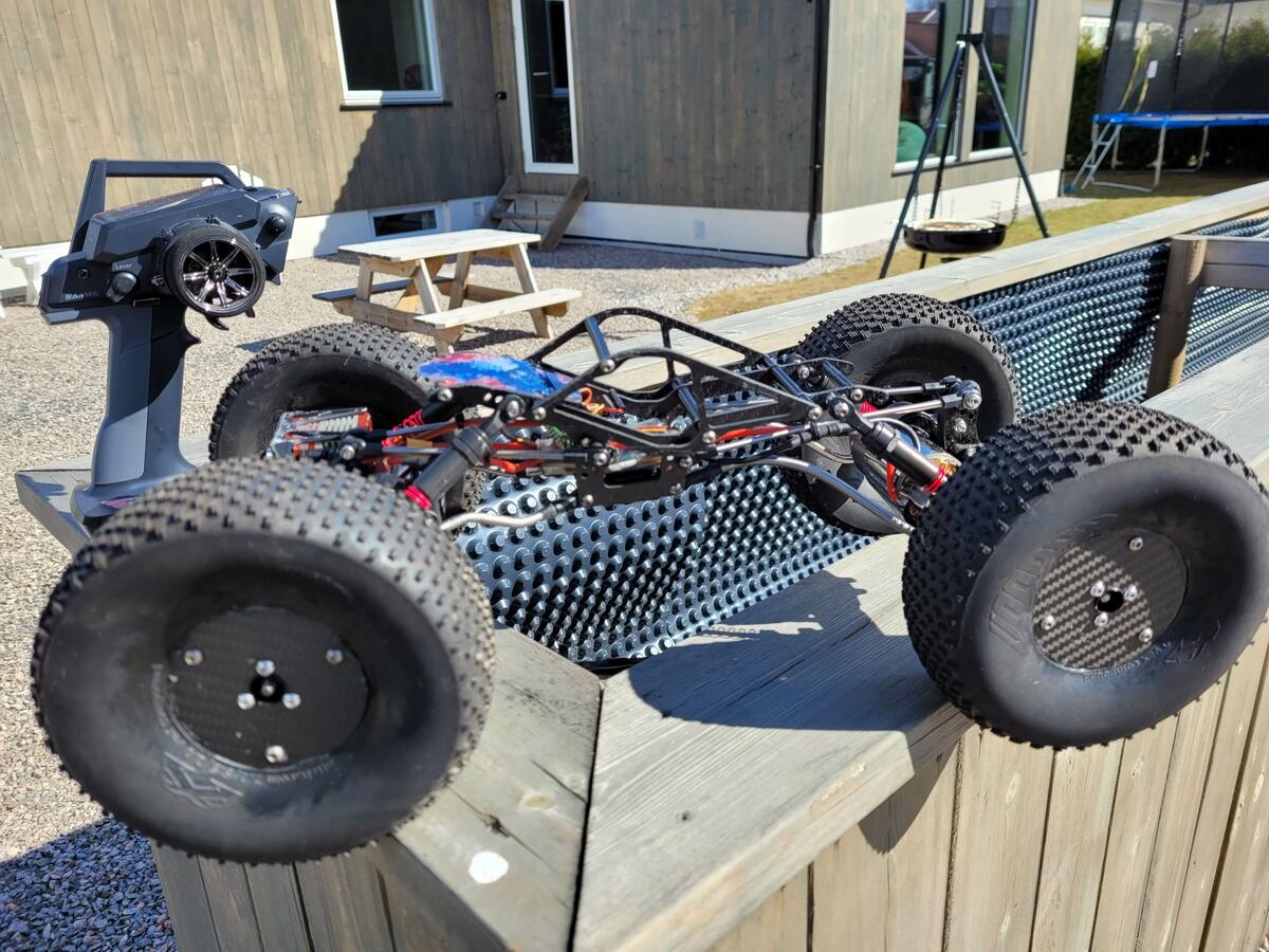

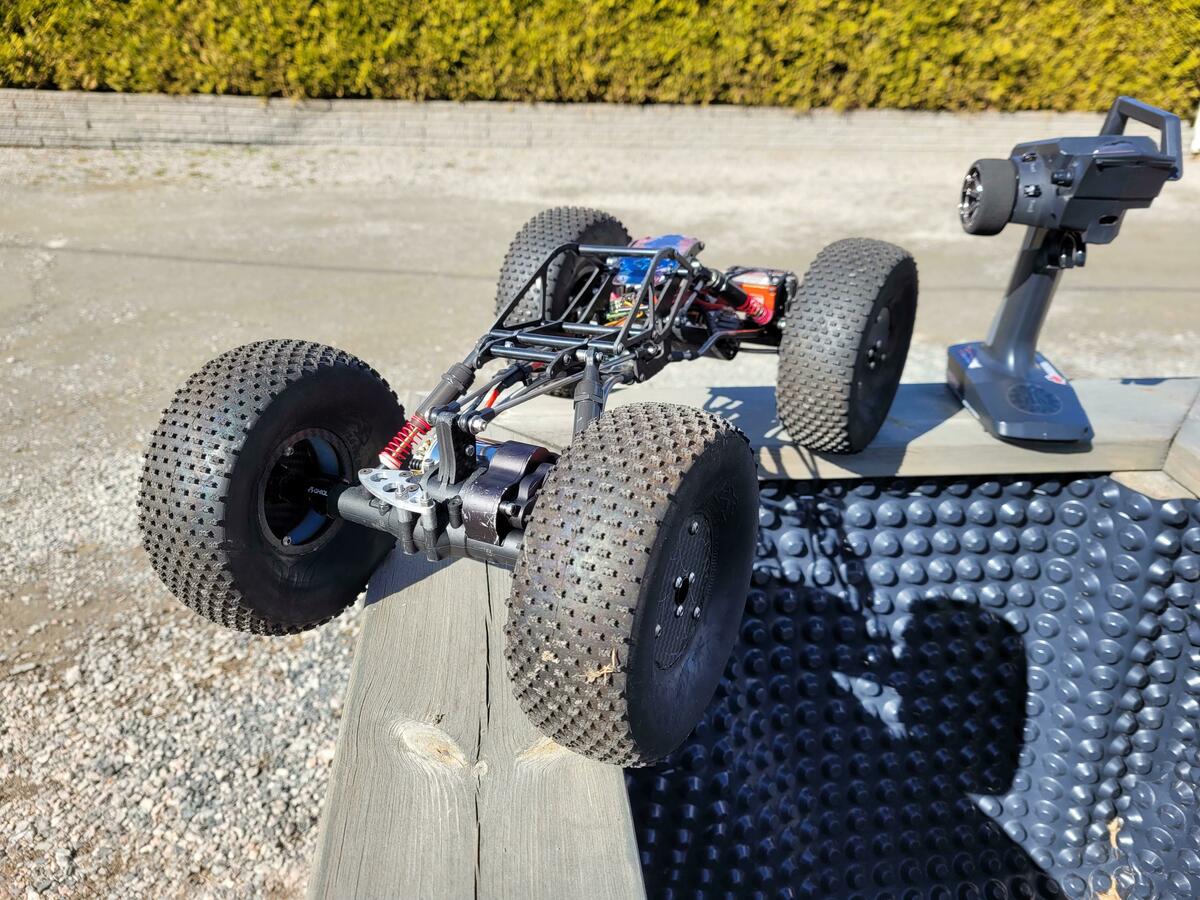

        • #5
          I removed that awful green skin, and revealed that nice carbon chassis and a early Krawler Konzept hood skin
          Got it setup to my Sanwa MT-4S, and took it for a testdrive.
